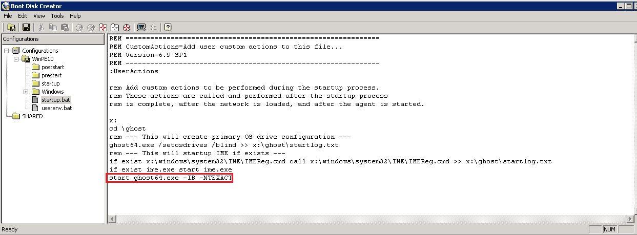

  1. Launch Boot Disk Creator as Administrator.
  2. Expand the configuration you want to change.
  3. Click on Startup.bat under your configuration.
  4. Locate the last line in the startup bat adding your switches after the line that starts Ghost. It is not case sensitive. See the examples below.
  5. We usually suggest -IB and -NTEXACT as default switches, you might also consider -NOTRIM. You can add any switches that are necessary for your environment here, but only add switches that you want to run every time you use that boot disk.
    Here is a partial list of command line switches that are available in Ghost.TECH130961
    If you just want to run Ghost with command line switches just once follow the steps in this article: TECH108178
  6. After you have modified the startup.bat file in your configuration save the change to the configuration and recreate your boot disk.
Examples:
You will either see one or two places to launch Ghost in the startup batch file. If you only see one, modify that one, if you see both, modify both.
A)
start ghost64.exe
should be changed to
start ghost64.exe -ntexact -ib
Before:
After:
Similarly:
start ghost32.exe should be changed to
start ghost32.exe -ntexact -ib
B)
if exist ghost32.exe (start ghost32.exe) else (start ghost64.exe)
Should be changed to this:
if exist ghost32.exe (start ghost32.exe -ntexact -ib) else (start ghost64.exe -ntexact -ib)
Before:
After:
