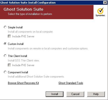

  1. Download the latest version of Ghost Solution Suite (From your Support Portal  ) and select "Extract & Execute App", this will create the familiar DSSETUP folder in the directory that is selected.
  2. Select Custom Install to preserve the database from the previous version of Ghost Solution Suite install.
