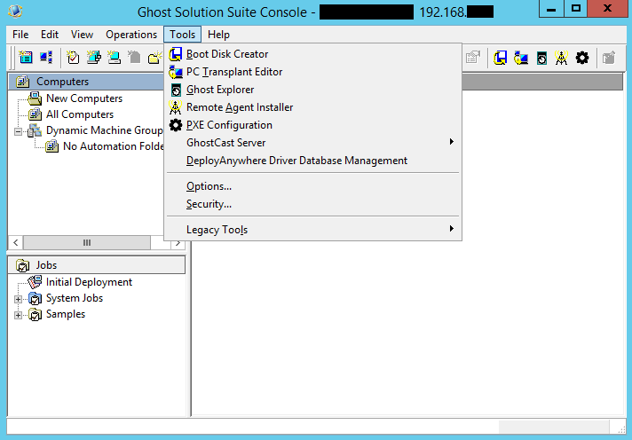

  1. Open Ghost Solution Suite and then open the PXE server configuration (Represented as a Gear icon in Ghost Solution Suite) as shown in the image below.

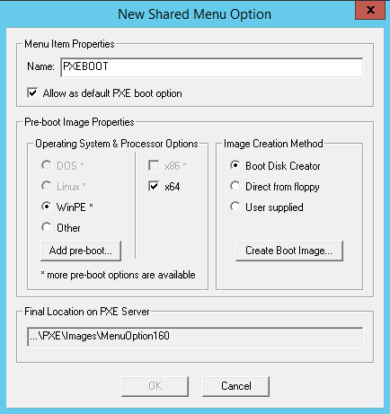

  1. Select “New...” on the right hand side of the PXE Configuration Utility window
  1. The first step in configuring PXE is to import a pre-boot environment. Select “Add pre-boot” on the left hand side of the New Shared Menu Option screen.
          *Note – Windows ADK and WinPE should be installed prior to this tutorial
  1. Select the WinPE environment that matches the Windows ADK installed earlier. i.e. WinPE 10 or 11.
    Select the Pre-Installed ADK radio button and navigate to the Windows ADK install folder (Typically: C:\Program Files (x86)\Windows Kits). Select next and wait for the WinPE environment to be imported into the PXE configuration.
  1. Now that a pre-boot environment has been imported, it is time to create a PXE boot environment.
    • First, give the PXE configuration a good name.
    • Make sure WinPE * is selected on the left hand column.
    • Select either x86, x64 or both depending on which WinPE environments were loaded in the previous step.
    • Select Boot Disk Creator on the right hand column and click the “Create Boot Image” button.
