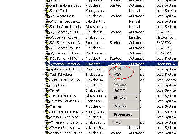

Steps to stop Service
Step 1) Go to Start -> Run and type services.msc as shown in the below screenshot
Step 2) Right click service window for Symantec Protection 6.0 for SharePoint Servers and select Stop option as shown in the below screenshot.
