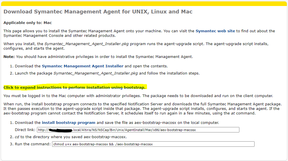

  • In the section labeled 'Pull install', select 'Mac' under 'Page view > Select platform:' as seen here:
  • Then, click the 'View page' link to see a popup window, and select the "Click to expan instructions to perform installation using bootstrap" as seen here:
  • Then select the 'install bookstrap program' option and follow the instructions to download and save the aex-bootstrap-macosx file on the local computer:

The most efficient method of having end users install the agent is to provide them with the download link. The actual link is:
     http:///Altiris/UnixAgent/AltirisUnixAgentDownload.aspx?Id=Mac
