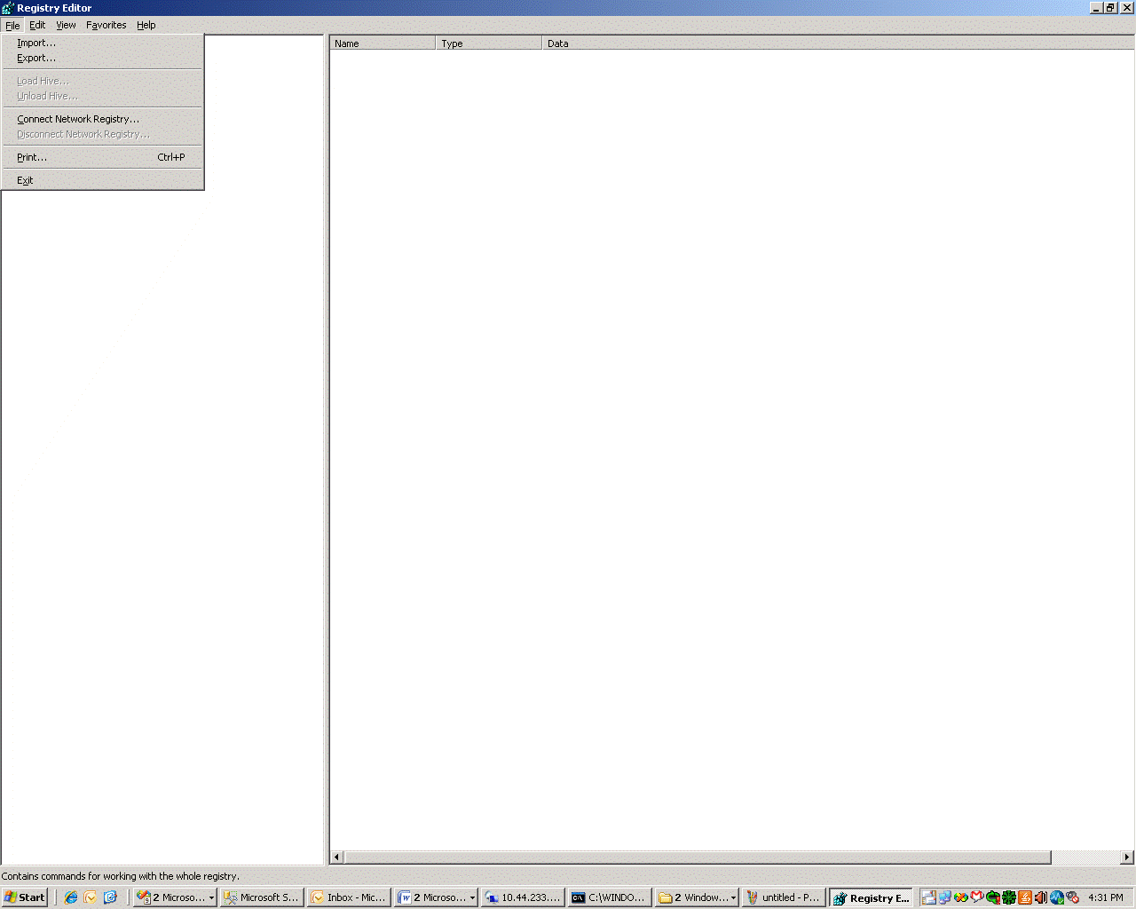

Steps to take back up of registry
     Step 1) Go to Start -> Run and type regedit as described in below screenshot
     Step 2) Click "Export" from "File" menu as shown in below screenshot.
     Step 3) Export the file with appropriate name and save it on disc. Select "All" under the Export Range before saving it to disc as shown in the below screenshot
