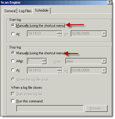

  10. Move to the "Schedule" tab, then select the following:

  11. Move to the "Schedule" tab, then select the following:
