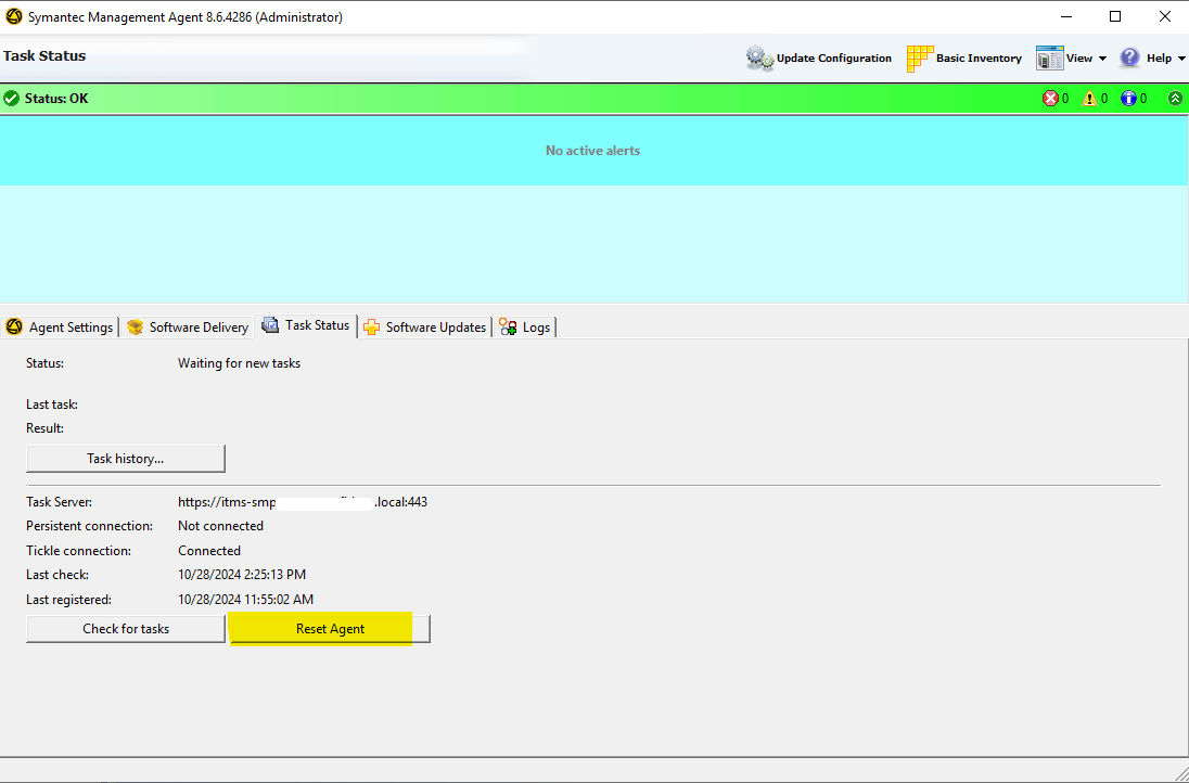

When you double-click on the Altiris Agent (Symantec Management Agent) go to the Tasks tab, and press the "Reset Agent" button, what does this do?
ITMS 8.x
It stops the task agent, restarts it, and then forces a check for new servers.  Restarting the Altiris Agent doesn't do the last step in that process unless the client has never checked in before.  A restart of the Agent will look to see if it has a task server known, and if so, will not try to connect to another.  In the logs, you'll see this:
CTaskServerNetCommsConnection::GetServersAndRegister(): Not getting new server list because we have <thepreviousserver> saved
Only if the client has not yet found a task server will it request a list from the SMP Server.  A Reset Agent though will force this check.  You can see the process in the logs, and it looks like this (the server list returned is highlighted):
