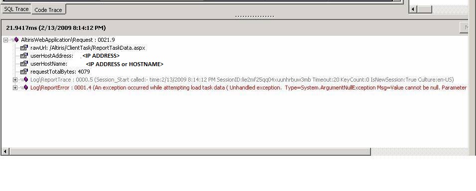

If you have not found the correct Task Server, it was recently discovered that the Altiris Profiler can be used to capture the IP address of the client machine that is making the bad request. Open Altiris Profiler on the Notification Server, begin a trace and look for the results that are similar to the screenshot below. In the screenshot below the IP address is listed in the userHostAddress field.
