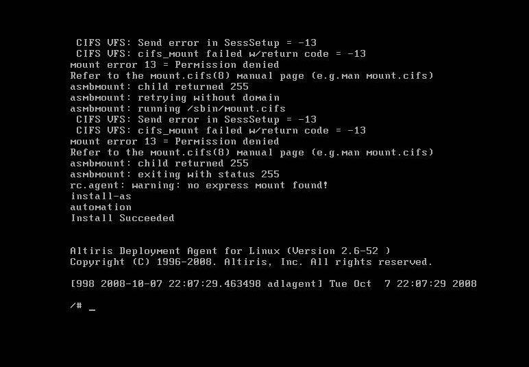

Simply change the Service account password that Linux automation uses during the authentication and you could possibly see this issue.
Linux boot does not authenticate. The error states, "No access smb mount: rc.agent warning no express mount found."
Network unreachable:
No express mount found return code 101 network is unreachable. Mount Error 13 = Permission Denied
