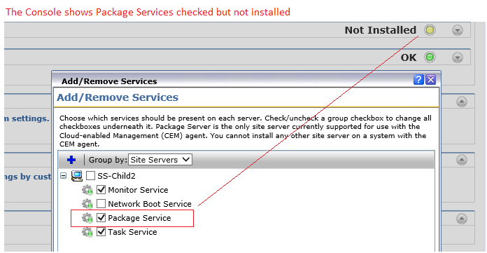

  2. The failed disk was replaced and the Symantec Management Agent was reinstalled. The reinstall of the SMA would eventually cause the Package Server Agent to show as uninstalled in "Sites Server Settings"
  3. In the console, under "Site Server Settings" the  "Package Service" option still showed as checked, but the UI showed that the PSA was not installed.
