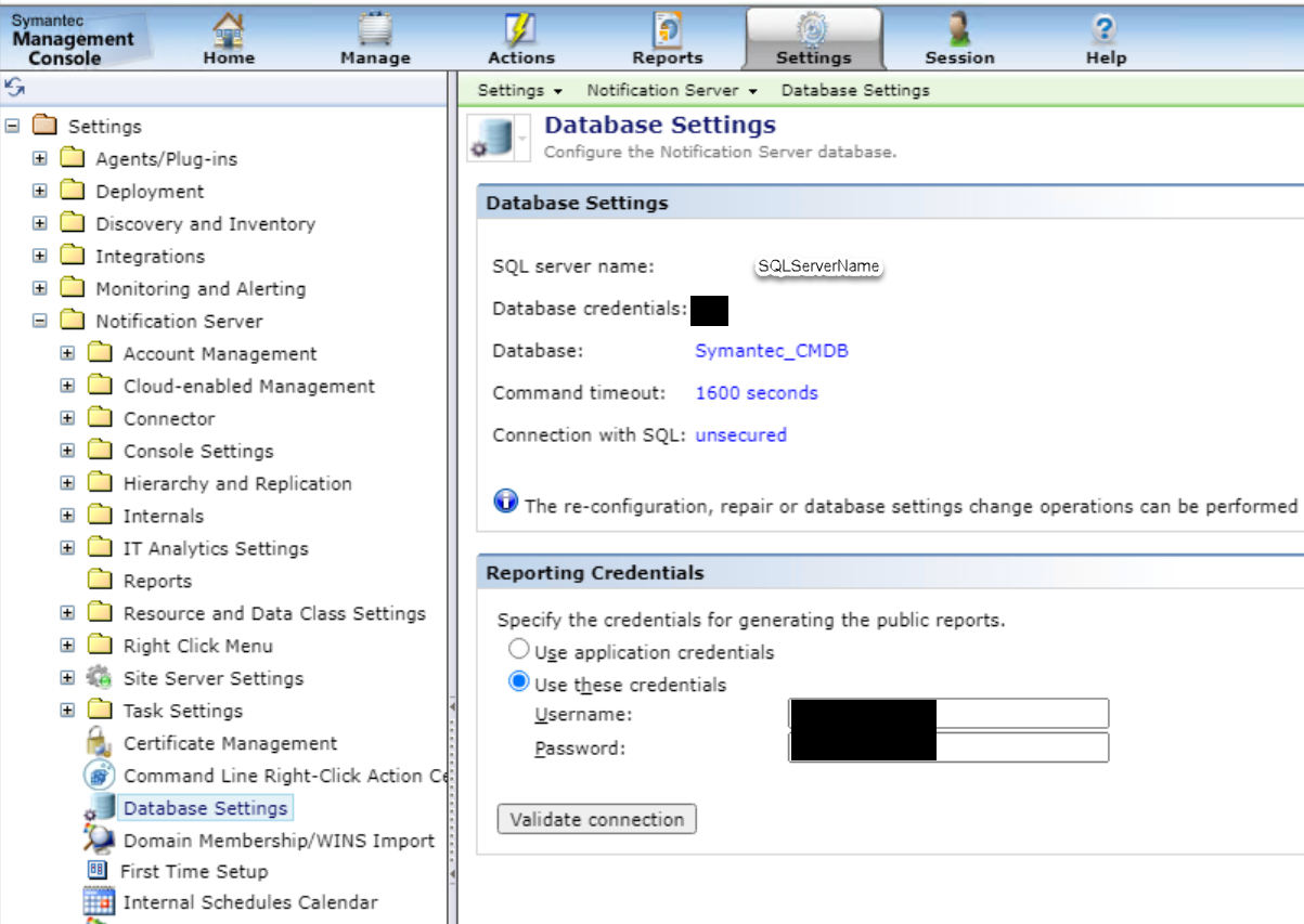

1. Database Settings on the Notification Server
Check on the SMP Console under:
Settings>All Settings>Notification Server>Database Settings

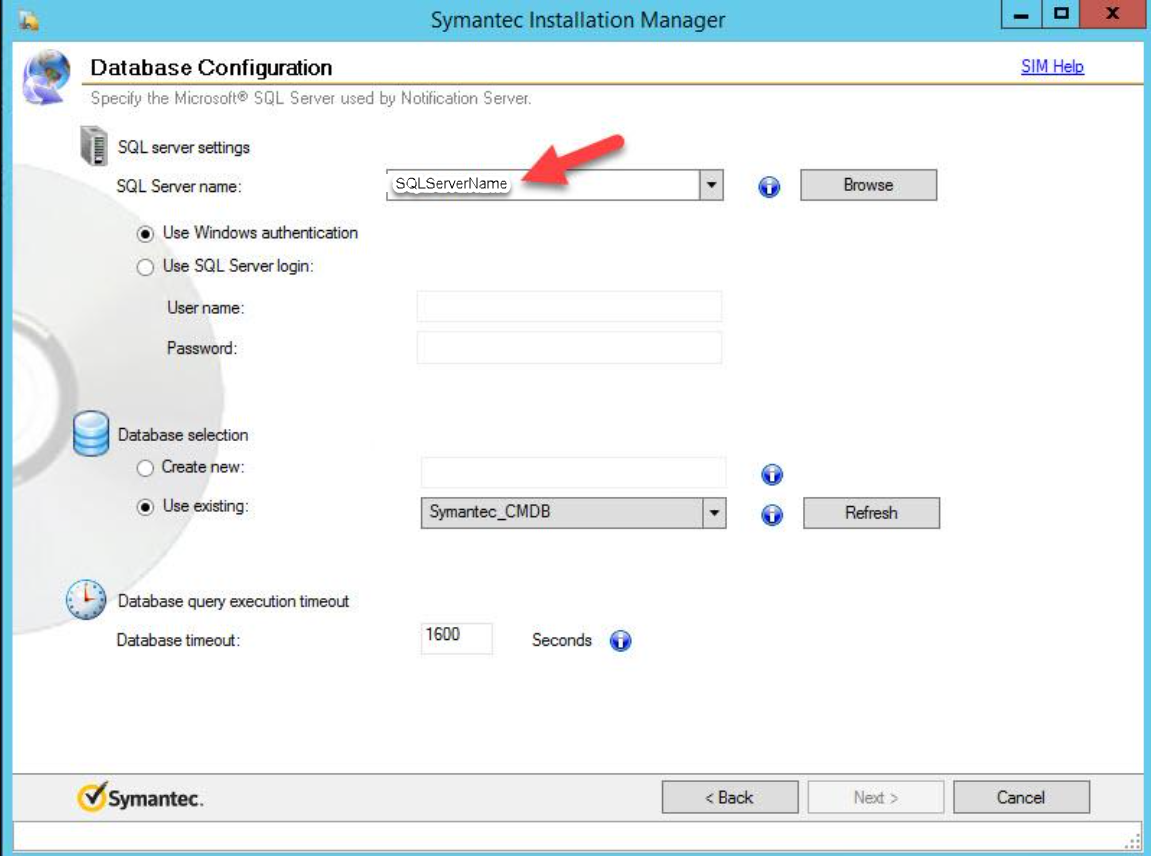

2. Symantec Installation Manager on the Notification Server
First, run the Symantec Installation Manager (SIM) on the Notification Server and click on "Configure Settings" and then double-click on "Configure Database Settings". You will see the following screen. The SQL Server name is found in the drop-down called "SQL Server name" (Red Arrow below).

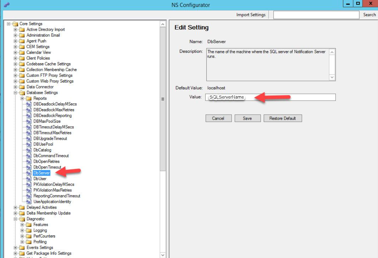

4. CoreSettings.config or NSConfigurator on the Notification Server
Finally, you will check the CoreSettings.config found at: C:\ProgramData\Symantec\SMP\Settings\CoreSettings.config.
Make a copy of the CoreSettings.config and place it in a directory so you can open it with Notepad or Notepad++ and check the settings.
  1. The setting to check is <customSetting key="DbServer" type="local" value="<SQLServerName>" />
  2. To edit the CoreSettings.config, use NSConfigurator.exe, found at C:\Program Files\Altiris\Notification Server\Bin\Tools
You can also use NSConfigurator (C:\Program Files\Altiris\Notification Server\Bin\Tools\NSConfigurator.exe) to view the setting.
You will find the setting here:
