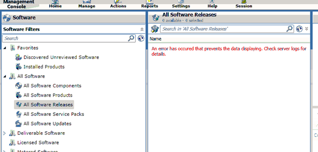

When attempting to access “Manage > Software > All Software Releases” and error is thrown in the right pane
An error has occurred that prevents the data from displaying. Check server logs for details.

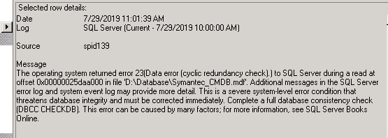

The SQL server logs contained the following error entry (excerpt) that calls out the problem as being some form of corruption in SQL.
Source:  spid139
Message
The operating system returned error 23(Data error (cyclic redundancy check).) to SQL Server during a read at offset 0x00000025daa000 in file ‘D:\Database\Symantec_CMDB.mdf’. Additional messages in the SQL Server error log and system event log may provide ore detail. This is a severe system-level error condition that threatens database integrity and must be corrected immediately. Complete a full database consistency check (DBCC CHECKDB). This error can be caused by many factors; for more information, see SQL Server Books Online.
ITMS 8.x
This issue is almost always not a Symantec product caused problem. The cause turned out to be due to a mistake made by a database administrator pulling a disk in the RAID 10 configuration. He had pulled the drive out before the light had turned on signifying that the drive was offline.  The result was that whatever was being written to the database at that time was corrupted and not retrievable.
In this case it was a or or more rows of data in the table “RM_ResourceFile
