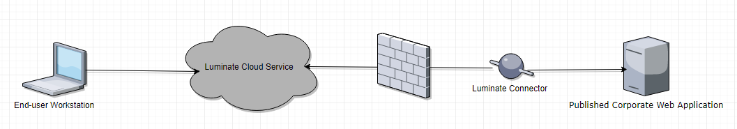

In order to get start with SAC, one needs to configure the system to provide access as described in the below diagram:
In the diagram above, users can access published applications via the SAC cloud service, as these applications have a SAC Connector component deployed in their datacenter. A separate guide explains the steps that need to be taken in order to configure applications for access via SAC.

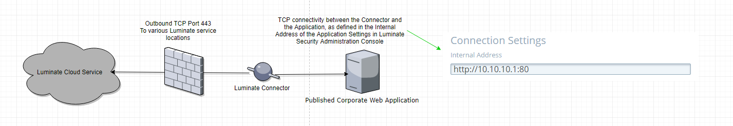

Below schema describes the communications that need to be allowed:
For those looking to restrict the allowed outbound TCP:443 communications only to the SAC infrastructure, please reach out to the SAC support for assistance. The exact addresses depend on the geographical location of your datacenter.
