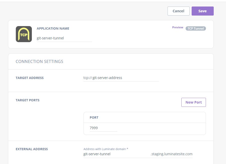

Step 1 - Define an SSH Tunnel in the Luminate Administration Portal for access to the git server(s)
In the Administration Portal, create a TCP Tunnel application in the site where Luminate Connectors have connectivity to the git server machine(s) or the load balancer proxy:
In the image above, please fill the following configuration parameters:
  • Application Name - will be relevant for the client-side configuration steps below
  • Target Address - a resolvable DNS or IP address that will be used by Luminate Connectors to connect to git server hosts
  • Port - an SSH port for git cli access (may have different values depending on your git server brand or configuration)
Please make sure to allow access to this TCP Tunnel application to the relevant organizational users/groups and to enable key authentication (for optimization of end-user experience).
