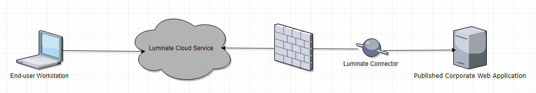

In order to get start with Luminate, one needs to configure the system to provide access as described in the below diagram:
In the diagram above, users can access published applications via the Luminate cloud service, as these applications have a Luminate Connector component deployed in their datacenter. A separate guide explains the steps that need to be taken in order to configure applications for access via Luminate.

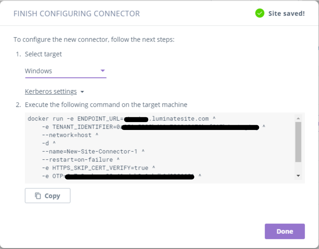

Upon saving the changes made to the site, for every new connector the following window will pop up:
Opening Kerberos settings is required if the connector is providing connectivity to applications using Single Sign On with Kerberos Constrained Delegation.
Please copy the content of the text box and run it on the Windows Server, making sure that the session user has permissions to manage Docker containers. The execution of the above command will pull the relevant version of the Luminate Connector from Docker Hub and initialize it, allowing it to reach out to the Luminate Cloud.
The configuration presented above makes sure that the container is restarted in any case it stops running, for example, if the host is rebooted.
