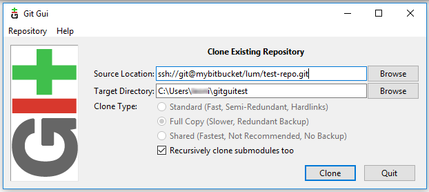

Cloning into git repositories can later be done in the following way:
(mybitbucket is the host name of the git server, as defined in .ssh/config and /lum/test-repo.git is the URI of the repository being cloned)
Same procedure can be carried out from Git UI:

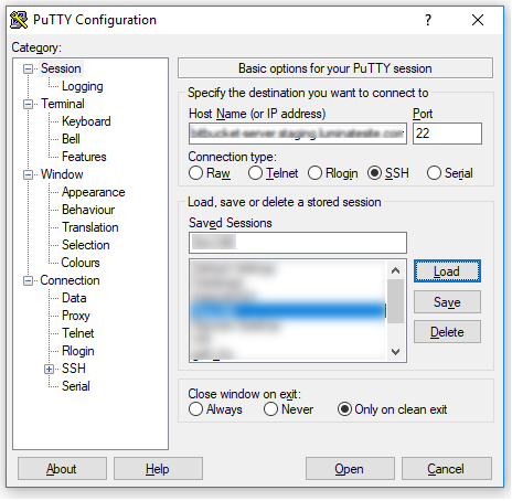

In the Session tab, define the following:
- Host Name (as appears in the Luminate Applications Portal) - <application-name>.<company-name>.luminatesec.com
- Port - 22
- Saved Session - git-server

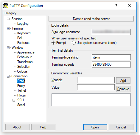

In the Connection --> Data tab, define the following:
- Auto-login username - User name as shown in the Luminate Application Portal (local_account@ssh-application-name)

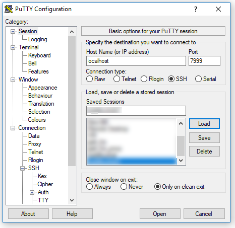

- Host Name - localhost
- Port - 22
- Saved Session - the host name that will be used in the git URLs

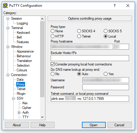

In the Connection --> Proxy tab, define the following:
- Proxy type - Local
- Proxy hostname - Doesn't matter if you don't use the %proxyhost variable in the local proxy command. Should be identical to the name of the session defined previously.
- Proxy port - Doesn't matter if you don't use the variable in the local proxy command.
- Consider proxying local host connections - very important that this is checked
- Telnet command, or local proxy command - plink.exe <External-tunnel-session-name> -nc 127.0.0.1:7999
