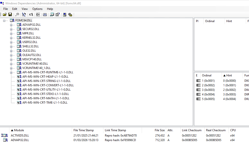

    Method 2: Using Dependency Walker To Find Missing Dependencies
    This utility is designed to help find the dependencies for .dll files. It will also show if the dependencies are missing or not registered correctly.
    1. Download the latest compiled release of WinDepends from the project's GitHub page: https://github.com/hfiref0x/WinDepends/releases
    2. Extract the downloaded archive to a folder (no installation is required, but you might need to install .NET Desktop Runtime 10.0 too).
    3. Run WinDepends (WinDepends.exe).
    4. Go to File > Open (or drag and drop) and browse to the .dll that is reporting the error. If the .dll is not present on the system, copy the .dll from a known good source or run WinDepends before closing the error / warning during a manual (not silent) DLP agent install. Once the .dll is selected it can take a few moments for the system to scan for dependencies.
    5. In the tree view, review the children of the .dll from the error.

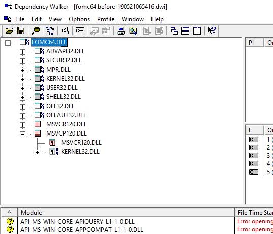

    6. Any .dll's shown with a red error icon are not installed properly and need to be either installed / repaired. (You will notice it automatically filters out standard Windows ApiSet false-positives). In the case above the problem .dll files are msvcr120.dll and msvcp120.dll. To reinstall / repair the .dll's find the parent program by doing a google search "How to install msvcr120.dll". In this case that .dll belongs to the C++ redistributable. (screenshot taken from previous Dependency walk tool)
    7. Once the source for the .dll has been reinstalled / repaired, restart the client machine.
    8. Do Steps 3 - 5 again. The dependencies should no longer have a red icon next to them.
    9. Attempt agent install again.
