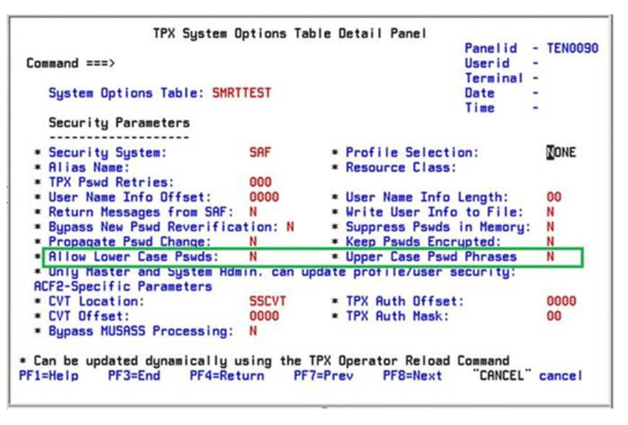

  3. Managing the case of Passwords and Passphrases
    When there is a need to address a mixed environment of upper case passwords and mixed case passphrases
    (where passwords are automatically set to upper case while passphrases are left in mixed case),
    then;
    PTFs RO73376, RO73377 and RO73378 UPPER CASE PSWD IN PWSD PHRASE ENVIRONMENT are required.
    These PTFs affect the available fields within the SMRT and will modify how passwords and passphrases are handled by TPX:
    1. Without PTFs RO73376, RO73377 and RO73378 applied:
      Set "Y" in field "Allow Lower Case Pswds:" on the TEN0090 panel.
      Most passphrase sites use mixed case passwords.
      If your site plans to use mixed case passwords then set "Y" in field "Allow Lower Case Pswds:" on the SMRT (TEN0090 panel:
    2. With PTFs RO73376, RO73377 and RO73378 applied:
      After these PTFs have been applied, field "Allow Lower Case Pswds:" will just be for passwords and not passphrases. The default is still "N".
      New Field "Upper Case Pswd Phrases" will be for passphrases only and defaults to "N".
