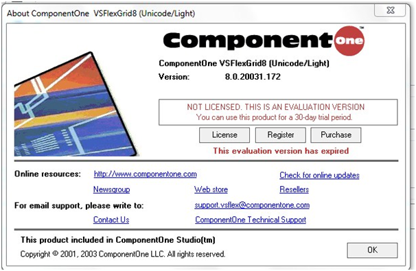

When trying to edit a computer or another asset type, such as a monitor, network printer, etc., a ComponentOne error occurs, which may occur all of the time or only occasionally. After closing this window, the user may be prompted for a network login to the Symantec Management Console. After canceling this or if this does not occur, the computer can still be edited without any issue.

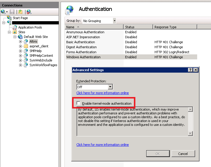

Cause: IIS is using kernal-mode authentication.
Solution: Disable using kernal-mode authentication on the Symantec Management Platform server:
  1. On the Symantec Management Platform server, open IIS.
  2. In the Connections window pane, click on to expand the server_name > Sites > Default Web Site.
  3. Click on Altiris.
  4. In the /Altiris Home window pane, under IIS, double click on Authentication.
  5. In Authentication, click on Windows Authentication.
  6. In the Actions window pane, click on Advanced Settings.
  7. If "Enable Kernal-mode authentication" is enabled, click to disable this.
  8. Click on the OK button.
  9. Restart IIS.
