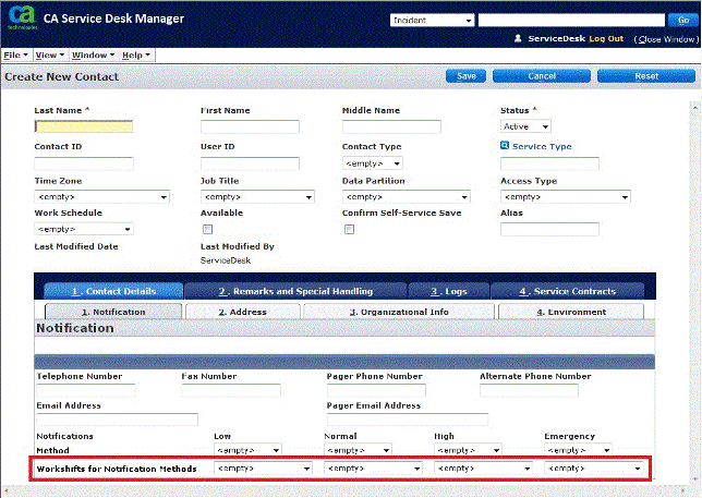

When we create a new Contact by clicking on <Create New> button, the 'Workshifts for Notification Method' field on [Notification] tab shows "empty".

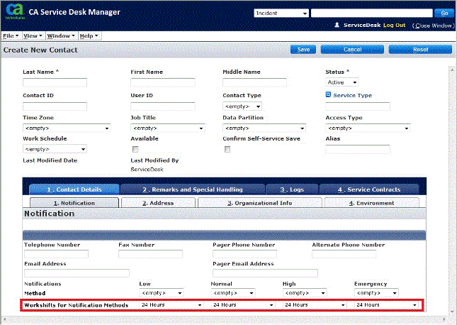

You will now be able to see "24 Hours" is shown as the default 'Workshifts for Notification Methods' by default.
