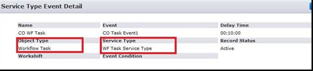

Create a new Service Type (or edit an existing one);
To the new Service Type, add a new Service Type Event with Object Type "Workflow Task" in the 'Change Order Tasks' Tab;

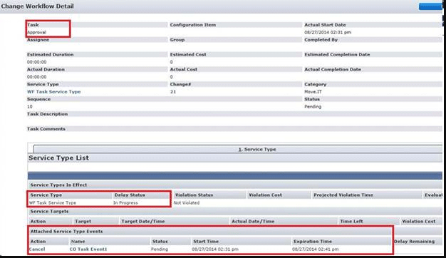

Go to the Change Order Detail, in 'Additional Information' > 'Workflow Task' Tab you can see the 'Approval' Task set to the Category Service Type;
Click on the 'Approval' task;
The unexpected behavior is that in the Task detail, the 'Delay Status' is as 'Not Active'.

To change this behavior and make the Workflow Task Service Type active, do the following:
Check if the option in Options Manager, 'classic_sla_processing' is as 'Installed';
Uninstall this option and restart the Service Desk Services;
The behavior will change and the next Change Order will show the 'Delay Status' as 'In Progress' in the Task Detail;
This way the Service Type for WF Tasks will be processed.
