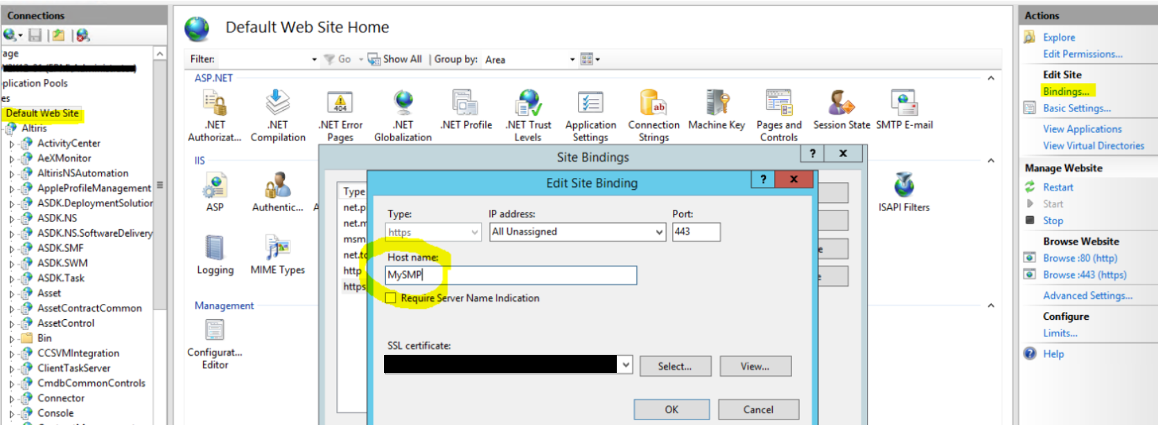

Misconfiguration. When checking the HTTPS binding on IIS, found "Host Name" field is filled with the SMP name
Verify and do the following:
  1. Open the IIS Manager on SMP Server
  2. Go Sites> Default Web Site
  3. Open the "Binding" (in the right pane)
  4. choose HTTPS and press Edit
  5. "Host Name" field should be empty
