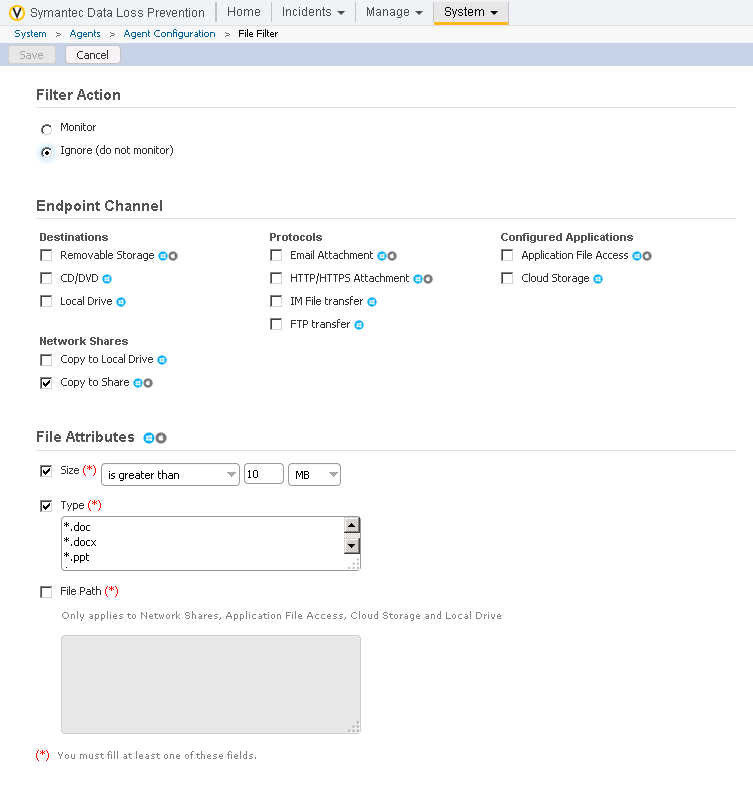

​Another approach to limit impact is to pick an upper limit for Office file types for the "Copy to Share" channel using a Monitoring Filter as shown below:
Files that match the File Filter criteria you set in the filter above will not have a File Restoration snapshot (SNP) created at Open, nor a VEP file created at Save, as the agent does not scan the file. A single SNP file still gets created during the Save from the existing document on the share, after the tmp files have been written, and before the interim tmp file gets renamed by the editing application to replace the contents of the document that is being edited.
