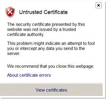

When navigating to the EEM homepage a warning may be thrown (as seen below) regarding the security certificate. This document outlines the steps required to eliminate this message by importing the EEM security certificate.

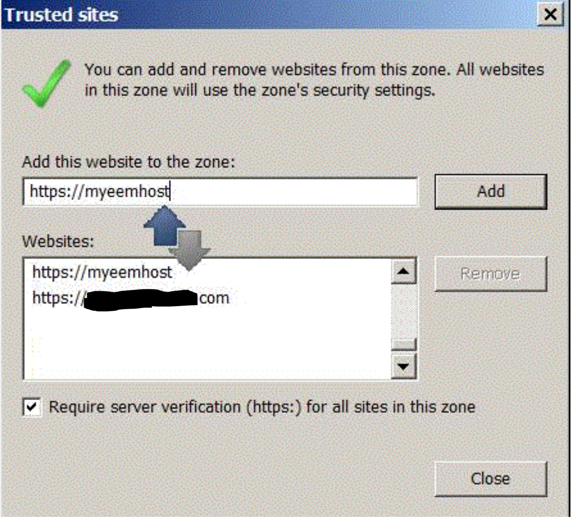

Add the EEM server hostname as a trusted site.
From Tools menu or widget, select Internet options
From Security tab, select Trusted sites, then click the Sites button.
Add the EEM server hostname to Trusted sites as seen below:
Format should be: https://<hostname>

Click on the Certificate error next to the browser address bar (as seen below):
Click View Certificates
