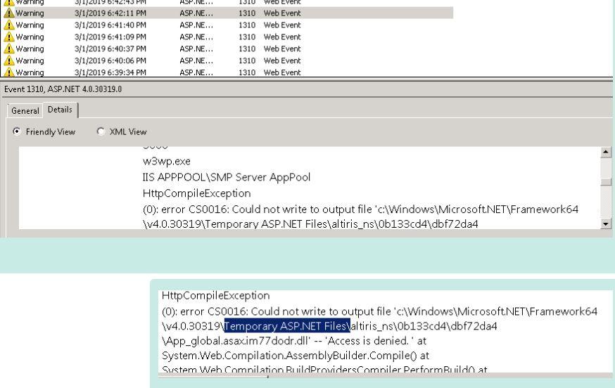

According to the Windows Event logs, there is an issue with access denied to "Temporary ASP.NET Files" folder:
ERROR: CS0016: Could not write to output file 'c:\Windows\Microsoft.NET\Framework64\v4.0.30319\Temporary ASP.NET Files\altiris_ns\2adb9e0d\e5203314\App_global.asax.77dodr.dll' -- 'Access is denied. '

HttpCompileException
(0): error CS0016: Could not write to output file 'c:\Windows\Microsoft.NET\Framework64\v4.0.30319\Temporary ASP.NET Files\altiris_ns\ob133cd4\dbf72da4\App_global.asax.im77dodr.dll' -- 'Access is denied. '

Make sure the following accounts/groups have permissions under "c:\Windows\Microsoft.NET\Framework64\v4.0.30319\Temporary ASP.NET Files":
Delete all Altiris related files in "c:\Windows\Microsoft.NET\Framework64\v4.0.30319\Temporary ASP.NET Files".

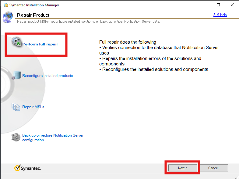

iisreset /stop in an elevated command prompt).C:\Windows\Microsoft.NET\Framework64\v4.0.30319\Temporary ASP.NET Files.iisreset /start).Try again the installation. Run a Full Repair ( SIM → Repair Installed Products → Perform full repair):
