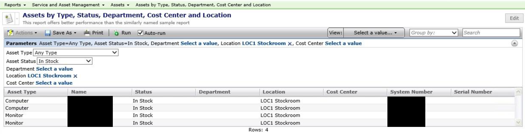

When you place a fixed asset in a stockroom, you then change its status to In Stock and update its Location to reflect the stockroom.
To see all fixed assets that are placed in the stockroom, use the Service and Asset Management Reports > Assets > Assets by Type, Status, Department, Cost Center and Location report, then filter by Asset Status and Location parameters.
