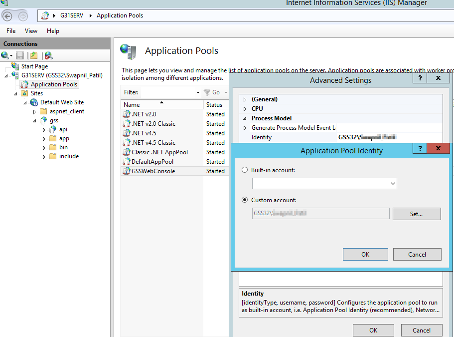

  1. Open IIS on the server where web console is installed (GSS server)
  2. Navigate to the Application Pools -> GSSWebConsole
  3. Right Click on GSSWebConsole and click on “Advanced Settings” option
  4. In “Advanced Setting” option edit the “Identity” option present under “Process Model” tab
  5. Set the user for “Custom account” which has Database access.
