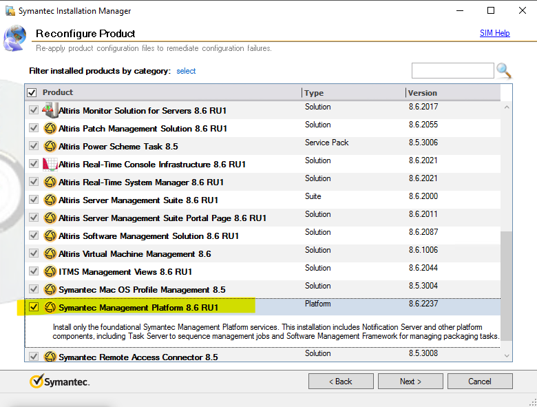

For Cause 2:
  1. Open SIM (Symantec Installation Manager) and run a reconfigure for the Symantec Management Platform so the missing reference can be recreated.
