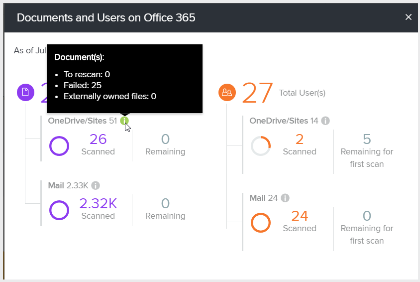

User has activated a securlet scan and after viewing the scan details, noticed some files have failed.

In most of the cases, the failed files will be will be retried. Re-scans for failed files occur on Mondays.

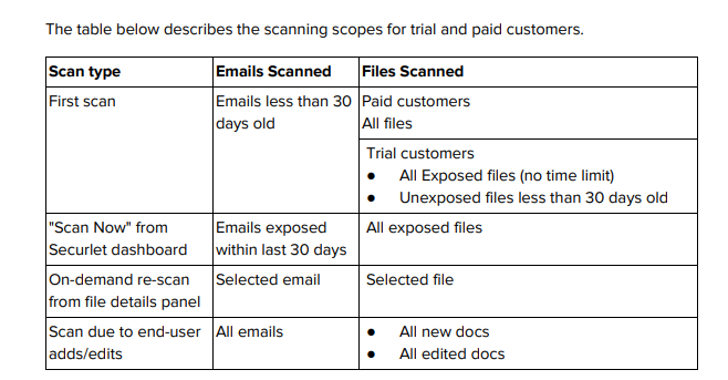

However, if your tenant is a POC or trial tenant, see screenshot below for files that may be skipped and therefore will not be re-scanned.
