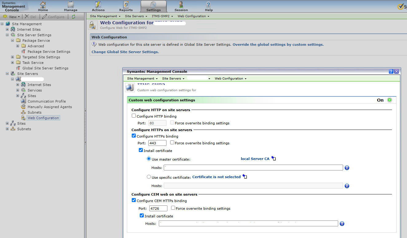

If the suggestion above works but after rebooting the package server the error "Package Server could not access own Web Site using HTTPS" comes back, please try the following:
On the SMP Console, under Settings>Notification Server>Site Server Settings, find the affected Package Server under "Site Servers" and click on "Override the global settings by custom settings" for the "Certificates Rollout" section (depending on the SMP version, it may be called "Web Configuration" section).
Make sure to:
After the package server gets the new configuration, restart the Altiris agent service. Check if the error is still present.

In another version, it may look like this:
