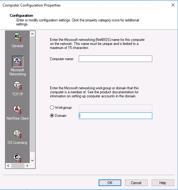

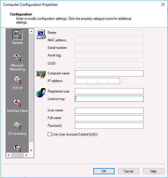

There are two methods for adding a managed machine to a domain through the Ghost Solution Suite console. The first method is to right click on the managed machine and click on Configure. The second method is to create a new job and add a Modify Configuration task. With both options you will be presented with a new window.
Click on the Microsoft Networking option. You'll be presented with the following page.
In the Domain: field add your domain.
For the right-click Configure option when you click OK, the domain join process will immediately begin. For the Modify Configuration job, you'll need to drag the job to the managed machine or the managed machine to the job and schedule it to run. Once running however, the domain join process is the same.
