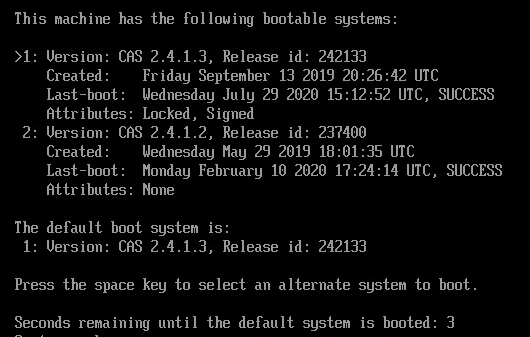

Method 2 - Reinitialize the Box
  • Restart the device.
  • During the boot process, press the space bar to halt the boot process. There will only be a few seconds to do this before the OS starts to boot.

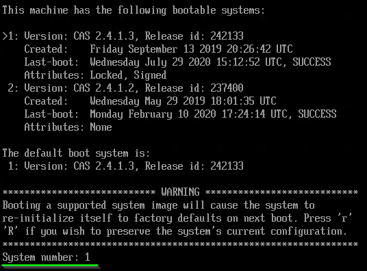

  • When asked to enter a system number to boot from, enter the letter r
  • You will be presented with the following message. Type y to continue with the process.
WARNING: The system will be marked for re-initialization. Booting a supported
system image will cause the system to re-initialize and result in loss of all
configuration and log information upon next boot. Furthermore, configuration
will have to be done while physically situated at the appliance. Proceed with
extreme caution. Continue with system re-initialization? (y/n)[n]:
  • Choose the system to default to.
  • The box will then begin the factory default process.
