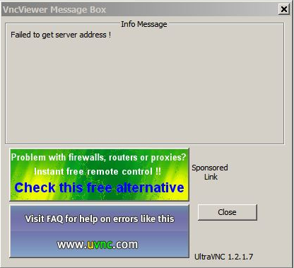

While trying to VNC (Virtual Network Control) into a computer through the remote control functionality of the Ghost Solution Suite console you receive the following error:
Failed to get server address!

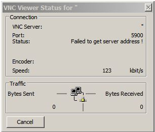

You may also see a VNC screen with a missing IP address like seen here:
