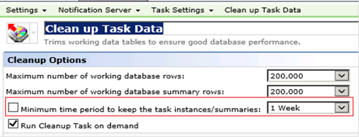

The following settings were used for "Clean Up Task Data" (in the SMP Console under Settings>All settings>Notification Server>Task Settings):
  • Max working rows = 10M
  • Max summary rows = 500k
  • Minimum time period to keep the task instances/summaries = unchecked
  • Run cleanup task on demand = checked

The issue was found to be with the list of task instances in the SMP Console for some jobs that were cleaned up by the “Clean up Task Data” task.
The TaskInstances tables may grow very quickly in environments with 10,000+ managed machines and intensive task usage, as the clean-up affects all of the records, even the recent ones.
To mitigate these problems, the option “Minimum time period to keep the task instances/summaries” was added in ITMS 8.0 HF1 as shown here:
If this option is selected then with default setting of “1 Week” then the “Clean up Task Data” task should ignore all the records which are newer than 1 week and not remove them.
