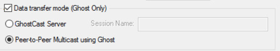

To resolve this issue you must first edit your existing deploy image task. Disable the Data transfer mode (Ghost Only) option and save the task. Then edit the task again and enable the Data transfer mode (Ghost Only) option. Choose the radial button for Peer-to-Peer Multicast using Ghost.

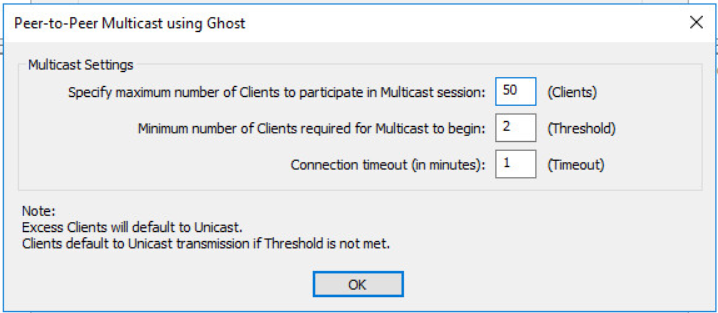

After choosing the Peer-to-Peer Multicast using Ghost option you'll then be given a new pop up box.
The value you want to focus on is the first one - Specify maximum number of Clients to participate in Multicast session: - the default value for this is 2. This means that if you schedule your multicast image job to more than 2 machines you will never achieve a peer-to-peer multicast session.  If you do not set this value at the time of initially enabling Peer-to-Peer then the default value of 2 is set and you aren't asked again.  The only option is to disable the Data transfer mode (Ghost Only) save the task and then editing the task again and enabling it again.  You want to change the default value of 2 to something higher like 50 or 100.
This will allow your multicast job to start with any number of machines below that value.
