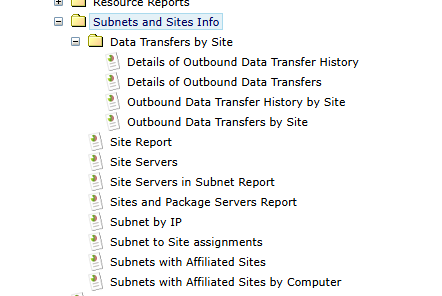

For ITMS 8.6 RU3 (available since 8.5 release) and later:
Refer to the followingdefault reports under "Reports > Notification Server Management > Server > Subnets and Sites Info" are available by default to help to have a better view of Subnets and Sites assignments:
"Is there a way to see which packages have not been downloaded by package servers or to see package-to-package server information?" (KB 150333)
