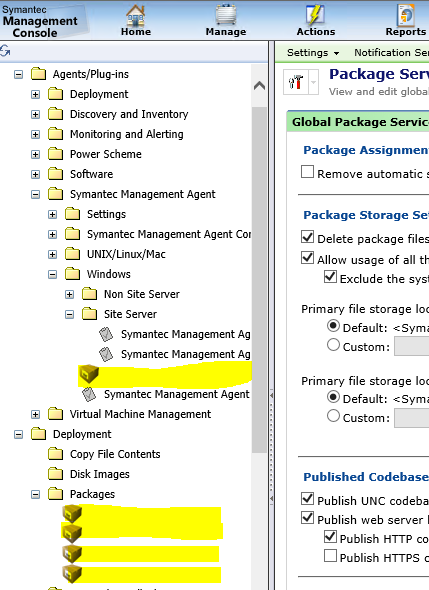

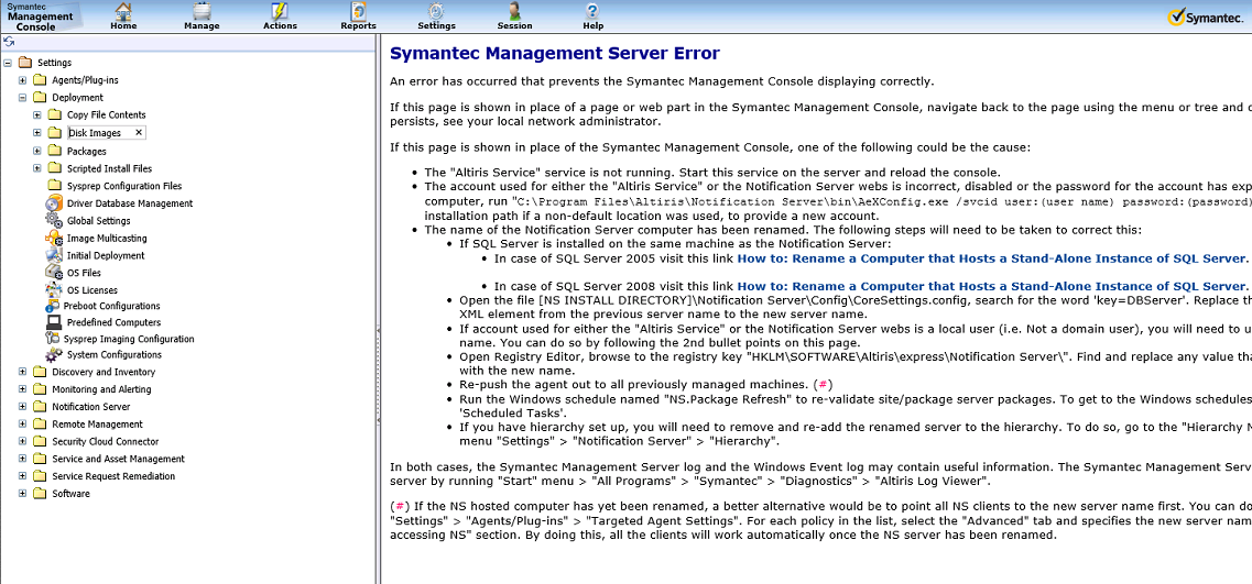

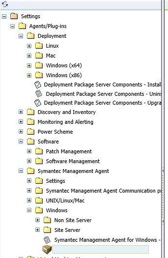

There is an issue with the SMP Console where there are specific views not showing when under the Settings > All Settings section.  For example, under the Deployment Solution section of the tree on the left hand side, when clicking on folders what should appear on the right hand side does not appear.  An error appears instead.  When you drills down on these folders the sub-categories only show their icon and not the wording that goes with it:
The affected items seems to be any one that has an icon for packages like under Settings>Deployment>Disk Images OR Settings>Agents/Plug-ins>Symantec Management Agent>Windows:
