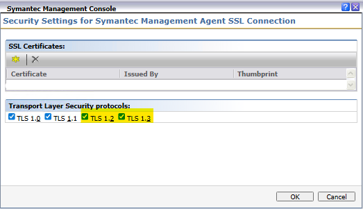

2.  Modify the SMP Communication Profile to allow TLS 1.2 and optionally TLS 1.3
  • Settings > Agents/Plugins > Symantec Management Agent > Symantec Management Agent Communication Profile
  • Select the SMP Profile
  • Edit the "SSL Certificates are defined for current profile" adding a check for TLS 1.2 (and/or TLS 1.3 if required)
    • NOTE: If any options are grayed out, they are not currently supported by the Operating System.  Make changes in Step 3 to Enable those options, and then come back and make changes.
