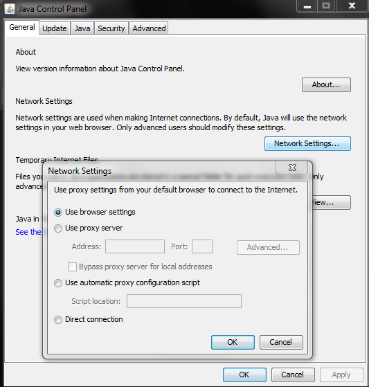

     Go to java and go to General -> Network Settings -> and make sure the settings are displayed as below or in Direct connection.

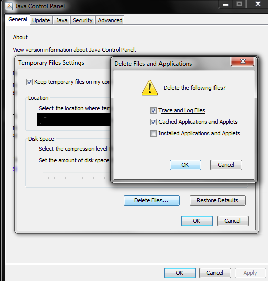

        Now clear java cache by going to -> General -> Temporary Internet Files -> Settings -> Delete Files -> Ok

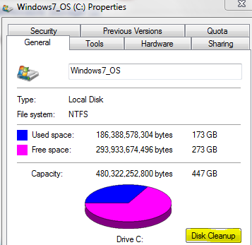

          Once completed delete cache from the browser and also do a disk clean on the drive as shown below:

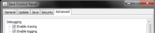

      If you are still not able to find the solution you may enable tracing and logging to see what the error java is seeing:
