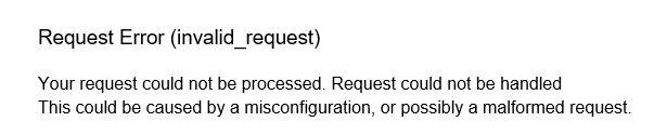

Also if your vulnerability scanning involves testing the device (SG/ASG/SGVA) itself against SSLv3, SSLv2 , You may still observe that vulnerability tools are reporting SG’s service port 443 is vulnerable , even with the above policy being applied. This can also be considered as false positive because when testing service port 443 (without connecting to OCS via proxy), SG will intercept the connection and perform SSL handshake (regardless of the SSL version) to present below exception message
Most vulnerability scanner tools considers this as vulnerable as SG is performing SSL handshake . (i.e Server hello , certificate was provided back to the scanner when it offered SSLv3 Client Hello). vulnerability scanner tools does not consider the actual HTTPS response being retuned by the SG.
