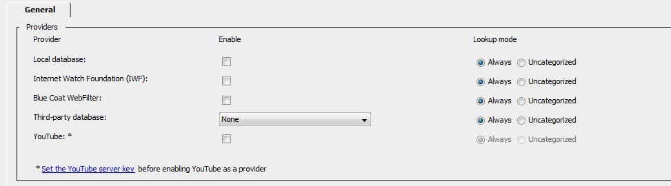

1. Turn off WebPulse service at Configuration > Threat Protection > WebPulse tab, then uncheck Enable WebPulse service option.
2. Make sure BCWF is not enabled.
