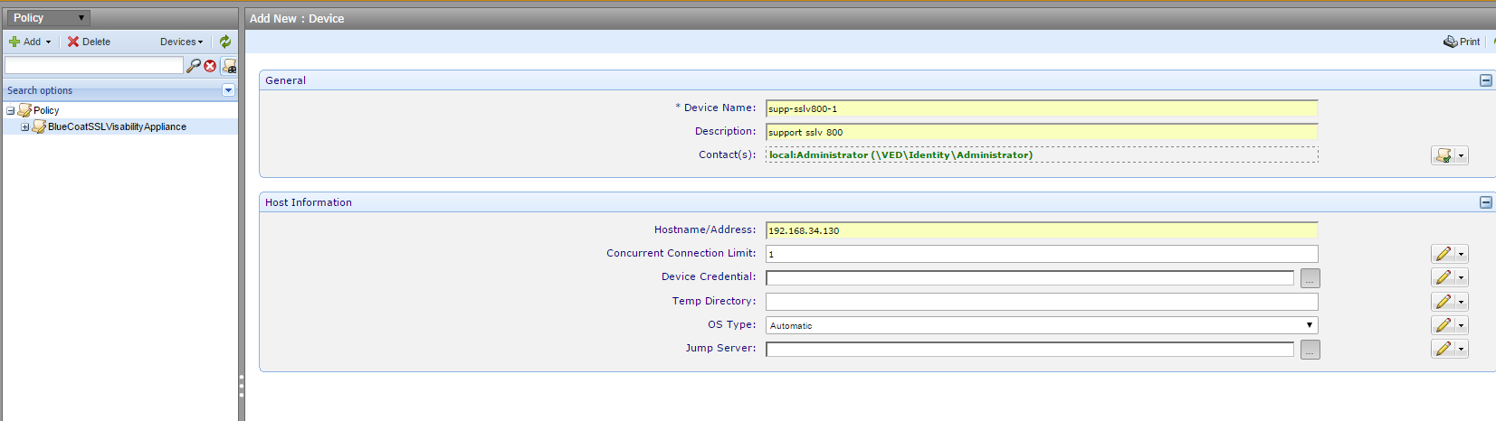

  1. Click Add > Devices > Device on the left side of the GUI and add the relevant information:
User-added image
  1. Click on the drop down at the end of the Device Credential text box and choose the BlueCoatSSLVisabilityAppliance folder from the Credential Selector text box.
  2. Click on the folder to open it and then click on the AutoSSLVCredential option and then click Select.
After doing this your Device screen should look like the following example.
User-added image
  1. Next, click Save. Your device should then be successfully saved.
