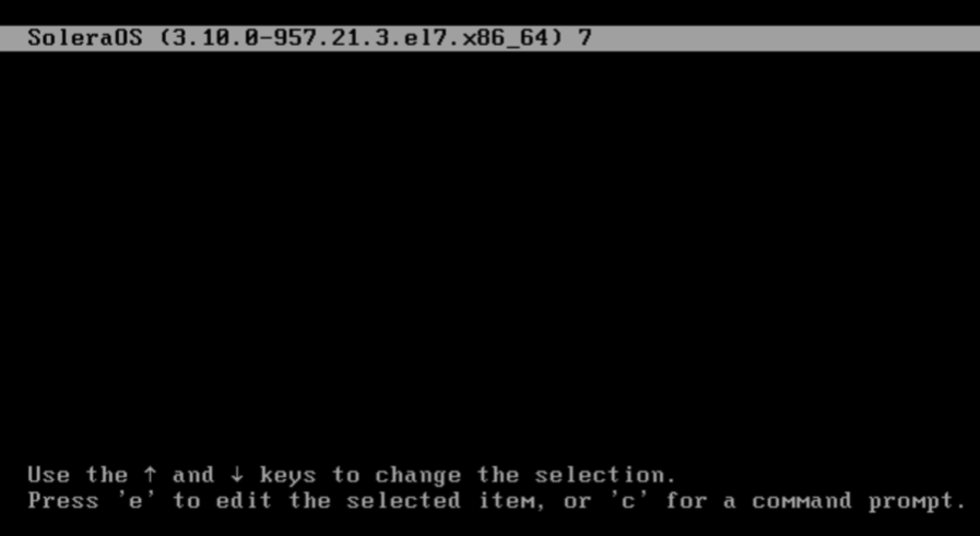

  1. Connect a keyboard and monitor to the appliance (or access the appliance via iDRAC remote console or any other IP KVM solution)
  2. Reboot the appliance and when you see the SoleraOS boot screen, press any key to pause the boot process
  3. Press 'e' to enter into edit mode.

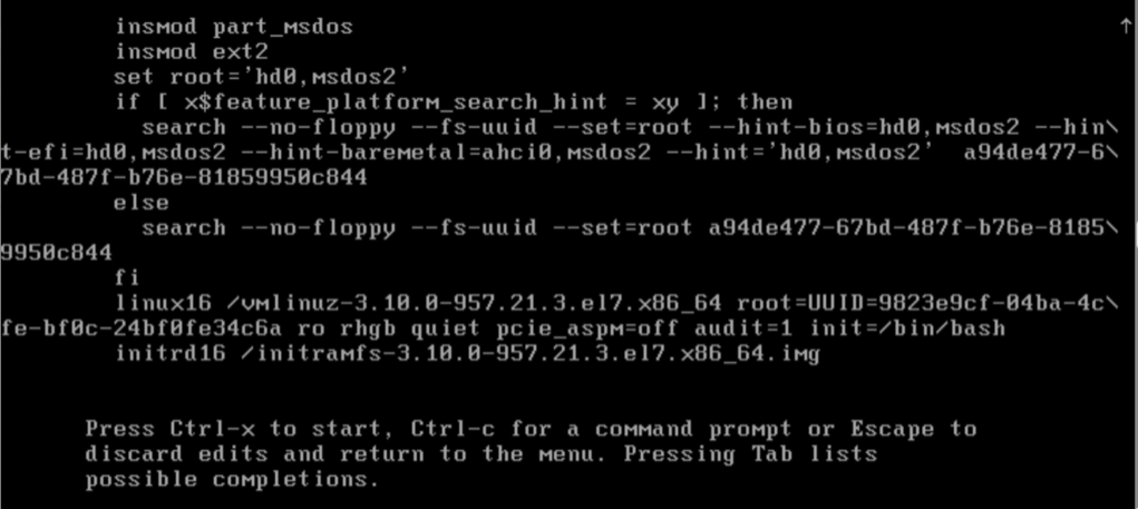

  4. Scroll down to the bottom using the down arrow until you locate the 'linux16 /vmlinuz' line.
  5. Place the cursor at the end of that line and enter:  init=/bin/bash   after the 'audit=1' parameter as shown in the screenshot above.
  6. Press Ctrl-x to continue booting the appliance.
  7. You will be placed at a bash-4.2x# prompt (or something similar)
  8. Remount the root filesystem in read/write mode by entering:   mount -o remount,rw /
  9. To change the root password, enter:   passwd    and enter the new password
  10. To change the admin password or any other user's password, enter:    passwd user_name
  11. Reboot the appliance
