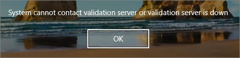

After installing VIP Microsoft Credential Provider, users see the error System cannot contact validation server, or validation server is down when trying to log into the server:

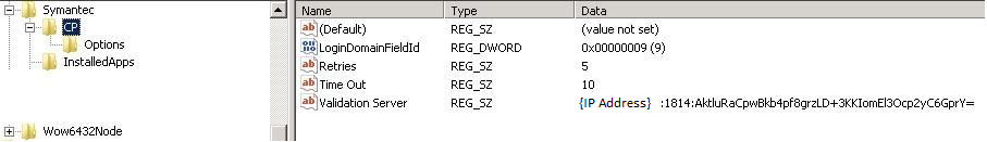

Use an IP Address rather than DNS name in the Validation Server registry destination setting.
Registry: HKLM\SOFTWARE\Symantec\CP:
LoginDomainFieldId (DWORD): 9
Retries (String): 5
Time Out (String): 10
Validation Server (String): VIP_EG_IPAddress:PORT:camouflaged_secret
sample:
