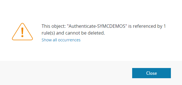

You receive the error "Realm <realm_name> is referenced by policy" when trying to delete an authentication realm.
The authentication realm is currently referenced within the current configuration.
Before a realm can be deleted from the configuration, it has to be clear of any reference in the policy and it can't be part of a sequence realm.

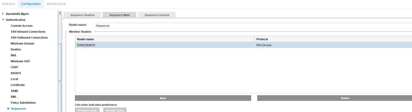

Verify the realm is not a part of any sequence realms.
Navigate to Configuration > Authentication > Sequences > Sequence Main, toggle through each sequence realm from the drop-down, and delete the realm if it is present.
