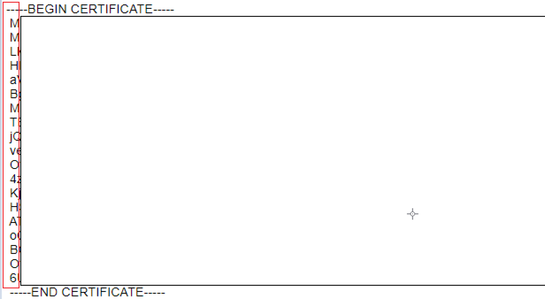

Cannot import the CA certificate or if it does import then the Certificate is not valid (Expired state).
Note in the following CA you will see a space in front of each line apart from the lines containing "BEGIN CERTIFICATE" and "END CERTIFICATE"
if you remove the space so the first character matches up with the beginning "-" of the first line then it will import correctly i.e.
If the certificate is already present then you should see "% Certificate Authority certificate has been imported already" and not an unspecified error.
