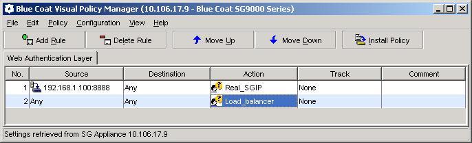

Add the real ProxySG interface IP access policy into Web Authentication Layer. You may have one of policy for load balancer access.
Add the new policy before the current load balancer policy.
  1. Add a rule to a Web Authentication Layer.
  2. Right click Source and select Set.
  3. Click New and select Proxy IP Address/Port.
  4. Specify the settings:
  • IP Address: the ProxySG IP address
  • Port: 8888
