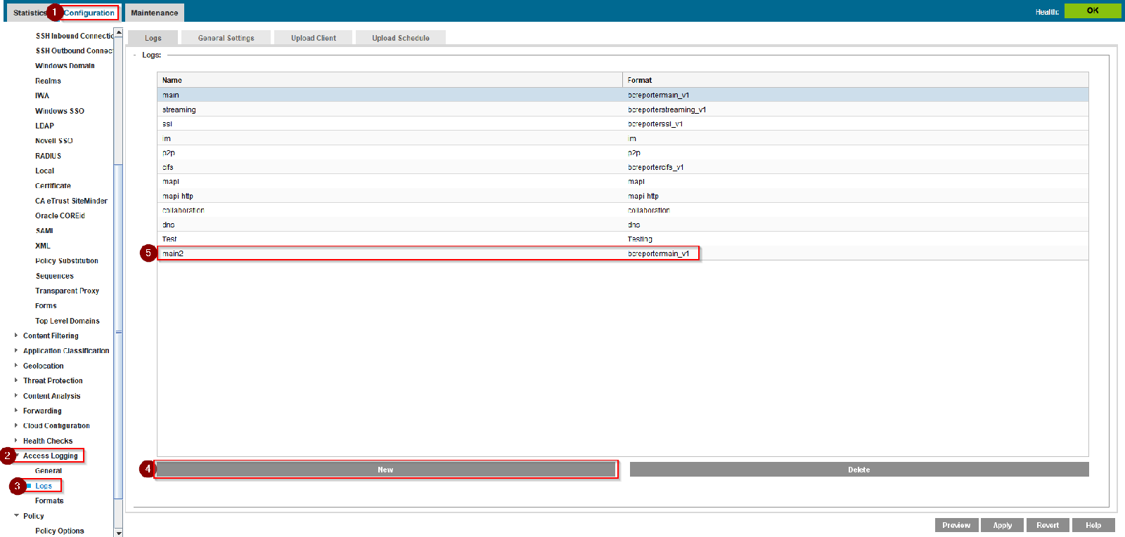

Step 1: You need to create another log
For example, if you want to send Access Log: main to 2 servers, you can create main2 using Log format main
- Configuration > Access Logging > Logs > New > Log Name: main2, Log Format: main > OK > Apply
