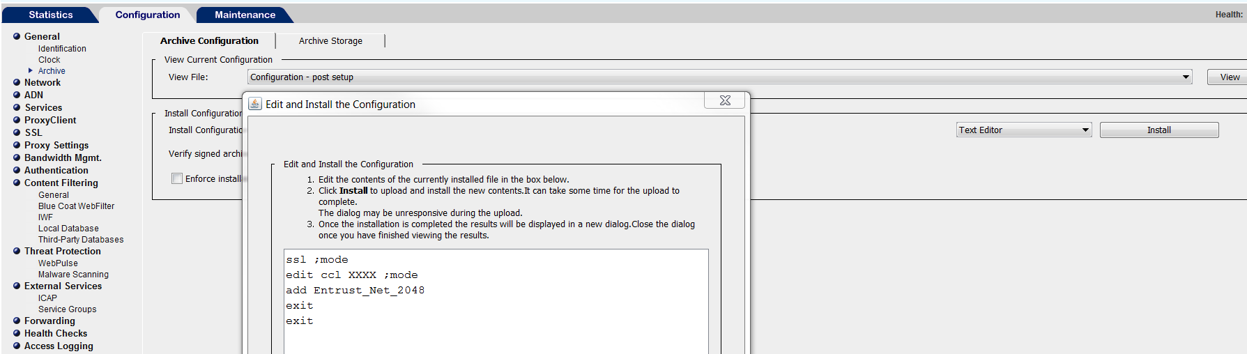

Otherwise, if you need to keep the OCSP responder configured as you currently have it and want to be able to upload data to Blue Coat from the unit, you must add the certificate chain to the CA certificates and then add them to the CCL you have configured (in our example XXXX) since that is the list used to validate the responder.
Just install this alone in the archive configuration text editor:
ssl ;mode
edit ccl XXXX_List ;mode
add Entrust_Net_2048
exit
exit
